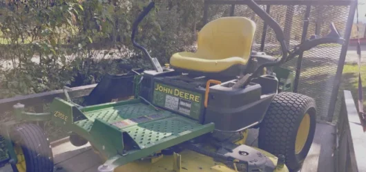

My JD Z355E lawn mower slows down.
George
Member
Messages
137
It becomes sluggish and slows down a bit when the blades are engaged. Any simple solutions?
could be something like a worn drive belt, dirty air filter, or blades needing a good sharpening and balance check
That John Deere looks solid Sluggish performance might just need a bit of maintenance love. Great to see you reaching outthese machines are built to last with the right care.
When the blades kick on and it bogs down like that, I'd definitely check the deck belt and make sure nothing's binding under there, even built solid like the John Deere Z355E can lose power if hte deck's fighting back.
Yeah I’ve run into that before. Mine slowed down like that when the deck belt was wearing out and the blades were a bit dull, quick check there might save you a headache
