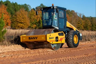

Great question, Mr.Woodpirate! From my experience, choosing the right compactor depends largely on the material and job specifics. For cohesive soils like clay, a tamping rammer works best due to its high-impact force. For granular materials like sand and gravel, a vibratory plate compactor is more effective. When dealing with large asphalt areas, a smooth drum roller provides the necessary coverage and compaction.
